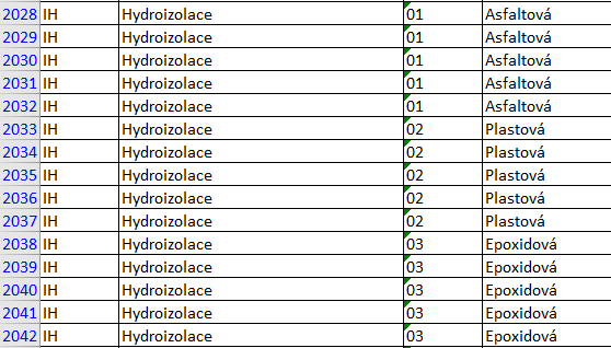

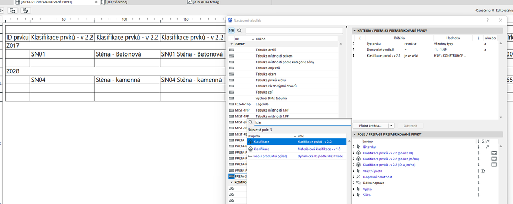

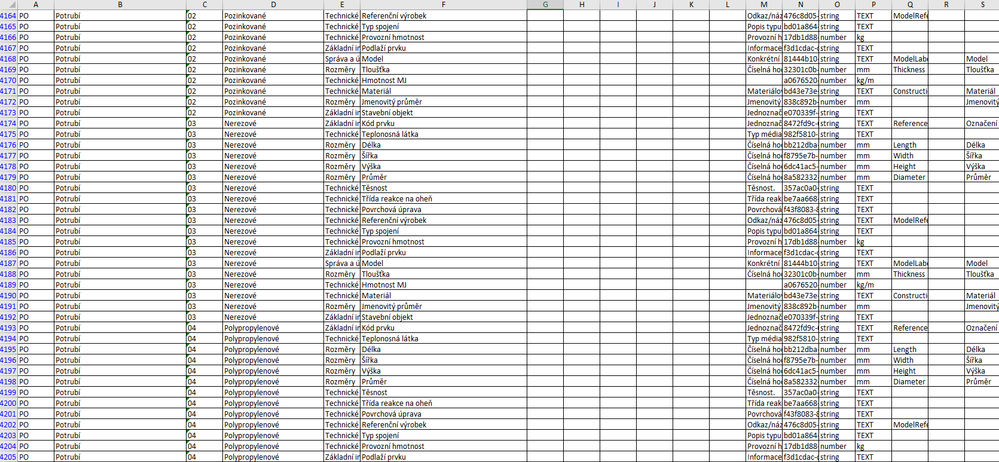

(1) I would like to somehow get those values from excel they distribute into Archicad's classification system. Please help to automate this. There are also properties that will soon (max 2y) be implemented as needed for different levels of documentation by law. (pic 3)

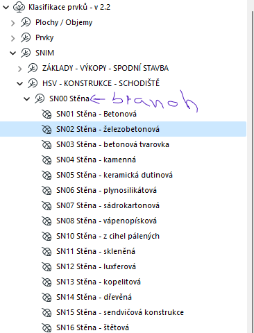

(2) If have to do it manually, for now, I will do only those I will use. But I would like to auto text the classification branch. So I don't have to enter it again and again. I know I can make a property that would add strings together or split one, but I can't find a way to auto text the branch name/ID. I also need the ID of classification to clean off any mess as I want to use it for assigning dynamic IDs.
