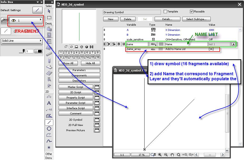

For the sake of discussion, I'll post a simple 2d Object that make full use of FRAGMENT2.
Everyone is welcome to try and see if this approach can be an alternative solution.......

Here is the Object
