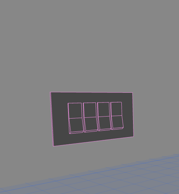

I’m using the default Electrical Switch (Switch US) object,  works perfectly in 3D and placement logic, but I’m struggling with its 2D Floor Plan representation.
The issue
In Floor Plan view, the switch displays large “SSSS” text symbols, which are very distracting and overpower the drawing.

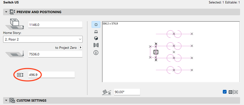

You can change the size of the Object to resize the symbol. In the upper pane, lower left corner, change 496.9 to a smaller number; this controls the length of the line through the "S", reducing it also reduces the size of the "S".
