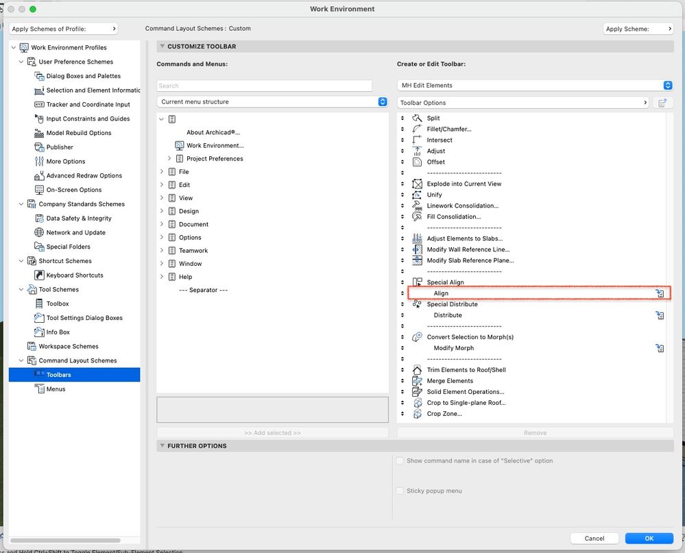

I am trying to create a dropdown menu within a toolbar such as the attached screenshots.
I cannot find a guide/post on how to do this. Does anyone have any ideas?

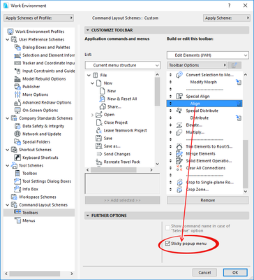

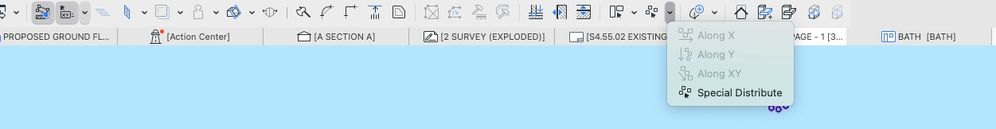

If you want just the pop-out triangle instead of the menu name with a triangle then you need to make the menu in the toolbar a 'sticky popup menu'.
I am not sure though why that option is greyed out in your image.

I think what I am trying to work out is, how do I create a menu that is housed within a toolbar, like the attached screenshot.
James

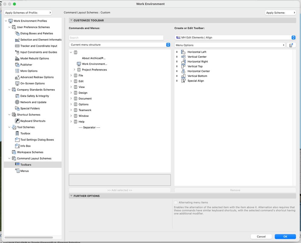

You have to create a menu in the menu structure first - even if you don't use it as an actual menu.
Then you can add that menu to your toolbars.
