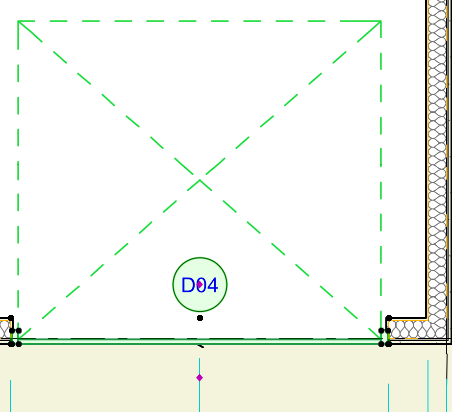

I just noticed a mistake in numbering on my door schedule - went in to manually change the ID of the garage door. It shows the properly updated ID on the schedule and legend, but the view and all corresponding plans still show the original ID. Any ideas why this is not updating?

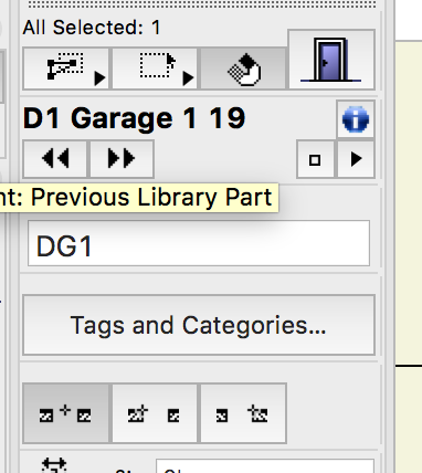

second screenshot
Figured it out! Had the marker settings set to custom rather than pull ID.
