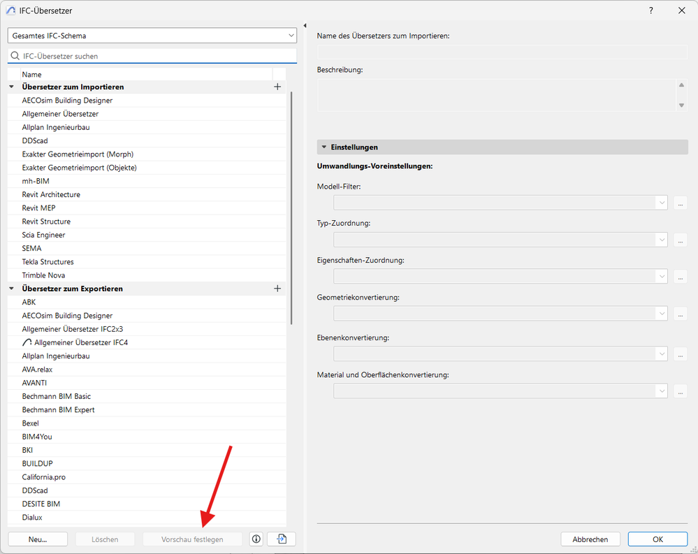

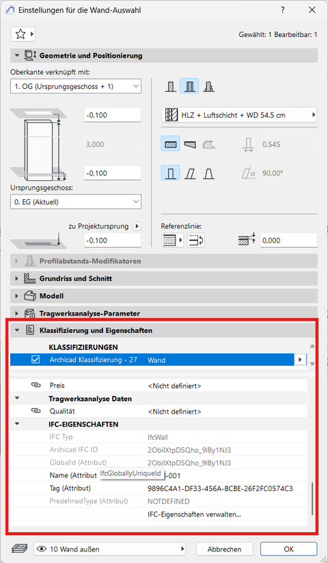

Have you already tried setting the IFC translator you're using as preview?
Then you should be able to see the IFC properties of the element at the very bottom of the element properties.
Maybe that will help you solve the actual problem.
