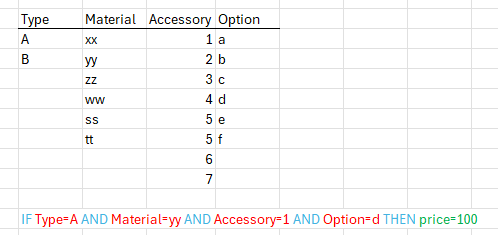

I have properties and want to drive values from combinations of these properties but I can't figure out how to. Any takers?

Hi Mats, if you mean like the little formula beneath try something along the lines of:
IFS (
    AND ( Type="A"; Material="yy";etc..); "100";
    AND ( Type="B"; Material="zz";etc..); "200";
Hope that helps!

like this with a number type property
IFS ( AND ( {Property:Généralités/Type} = "A"; {Property:Généralités/Material} = "xx"; {Property:Généralités/Accessory} = "1" ); 100; AND ( {Property:Généralités/Type} = "B"; {Property:Généralités/Material} = "yy"; {Property:Généralités/Accessory} = "1" ); 200 )

Got it to work. Thanks! Seems like the same code as Lucas suggested. I don't know went wrong earlier...
I get grey hair from the syntax and the editor....
