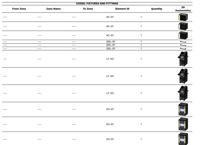

Hi all,
I am trying to put together a FF&E schedule for our office template that orders objects by their location.
I know that a door schedule will pick up the location of a door based on the zone associated with a given door. Is it possible to achieve this with objects also?
See the images attached; I have placed several objects in a full storey height zone as a test, and have had no luck getting the schedule to identify the objects' locations.
Does anyone have any good suggestions on how I might get this to work?

It's not clear which field parameters are being used in the screen shot schedule.
To Zone and From Zone won't work for objects.
It should be "Related Zone Name".

Yep, changing the parameter to "Related Zone Name" does the trick - thanks!
