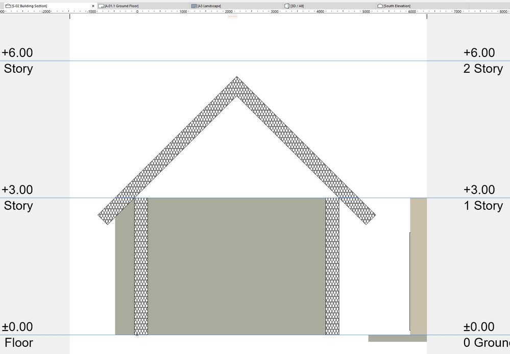

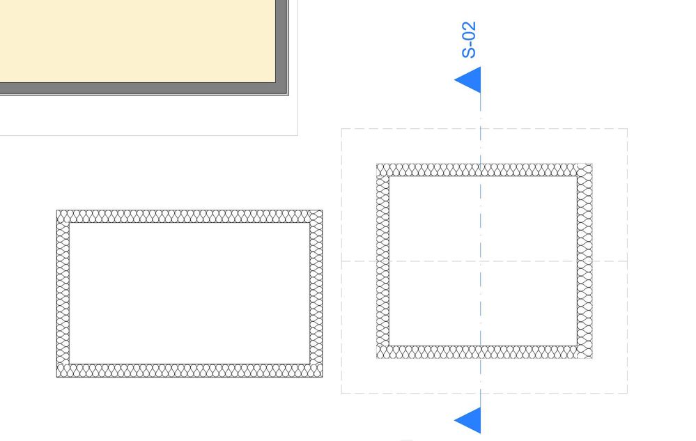

'insulation01' works perfectly 'fit to skin' on floor plan , but not on section.
I'm AC29 User.

You need to be using composite walls rather than basic structure.

Oh. It works. Thanks very much.
