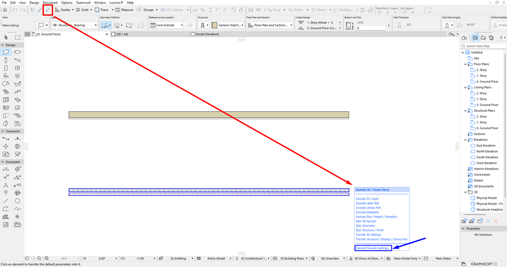

You can also use the eyedropper, that way you ingest everything from a placed element.

I just want to add a small note about using the eye dropper tool. You may already be using this.
I think it’s critical to modify the element transfer settings that appear before injecting the parameters. If the properties of the elements to be transferred aren’t set correctly here, there may be issues.
Br,
Sefa

@sefa Can you please expand on that and give an example of how there may be issues?
