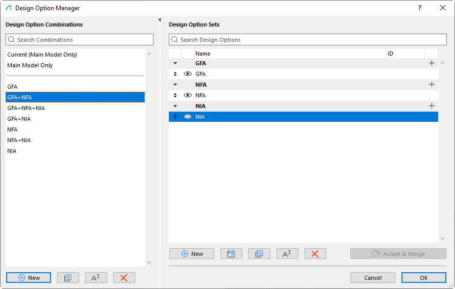

You can create a Design Option Set for each set of Zones (you use Design Option Sets instead of Layers for each group of Zones). Each Design Option Set would contain one Design Option. Then, you could create Design Option Combinations that would display those Design Options in those Design Option Sets in any desired combination. The trick is not to create a single Design Option Set and create within it Design Options for each Zone group, because at any time, you can display only a single Design Option of a Design Option Set. But if you have multiple Design Option Sets, one Design Option within each Design Option Set can be concurrently displayed so you can display all zones if you want, if you do it this way.

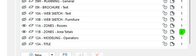

The easiest way to manage this one is layer priorities.
We run all of our overall zones on a different layer priority to our walls containing the doors, door markers and room name zones.Zone Layers.jpg

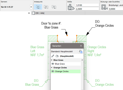

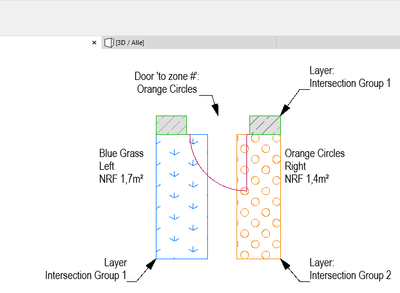

This won't help - altough (@GRAPHISOFT) it would be the logical way to seperate things.

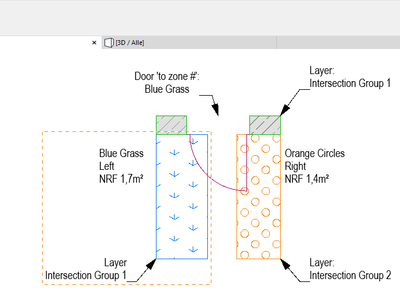

When it comes to the "from zone / to zone" logic of doors, 'the oldest zone in database' wins.
The "Intersection Group" has no effect (BTW: it's not a priority in the sense of 'the more, the stronger').

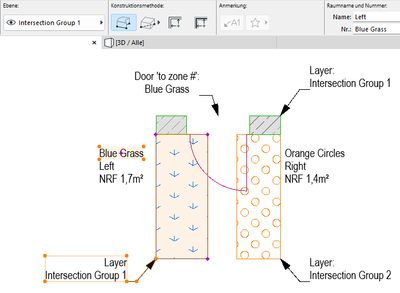

You can easily check that by Cut&Paste the actually shown zone out and in again.
Before: Door to 'Blue Grass', which is the 'oldest' zone

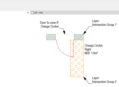

Cut (after CTRL-R for update): Door to 'Orange Circles', now the oldest zone
Paste back:
After (CTRL-R again): Door sticks to Circles, now the 'older' zone.

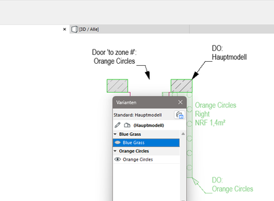

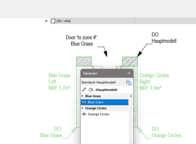

If Design Options enter the scene, this logic is extended to 'the oldest visible zone wins':
The DO of wall and door has no effect (visibility aside):
Conclusio:
If more than one zone set is visible, the oldest is shown.
One can make zones 'the oldest' by Cut&Paste the other zones.
