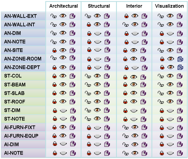

I am trying to update my template to ArchiCAD 19. Over many versions and many years of working on a wide variety of project types and scales my layer set and combinations list has ballooned into a crazy beast. Rather than build from scratch I am hoping to pare down and clean up what I have. I stumbled upon this image of a layer / combo matrix that would be a divine gift in helping me see what I got and help me roadmap my way out of pack-rat hell. Anyone have a clue how this was done? The visual lock and visible eye symbols are so much nicer that the text versions that I have so far spit out. Any suggestions would be greatly appreciated.

Through attribute manager if you select all layer combinations in the Attributes of the current project: side (left panel)
Make sure Include Layers is selected in the middle
Then push them By Index to the Current File: side (right panel).
Then do a save as .xml.
Open Excel and then open that xml file.
You will find rows and rows of layer combination info. They hold all the info you're after.
eg 1-2-22359-16-Layer Combinations-1_1 Site Demolition-1-2-0-629E2753-3AA0-4C05-AE0E-856CD9265B17-1_1 Site Demolition-1-0-1-0-0-1-1-166-1-1
I used '-' to show the column separators.
That 166 is the index code (attribute number) for my concrete dimensions layer (listed in that xml table with the 166)
and from memory the 3 numbers preceding that are the lock, shown, wire frame.
If you're good with excel lookups, you can make that grid, with graphics and all, pretty easily. I'm terrible with excel so I had one of our wiz's make it for me.

I did not find it too bad to use Excel to filter through an XML output of the attributes file:
1. Open the exported attributes in Excel. Rename the worksheet "DATA" (for the sake of this example, but can be anything).
2. Create a second worksheet.
3. In the new worksheet, list the Layer Index numbers in the first column ("A"), Layer names in the second column ("B") and Layer Combinations in the first row ("1").
4. In each cell of the matrix, paste this formula:
=INDEX(DATA!$N:$N,MATCH($A2&C$1,DATA!$M:$M&DATA!$C:$C,0))
Breakdown:
  • MATCH(es) the Layer Index value in column A and the Layer Combination name in Row 1 with the values in the DATA worksheet, columns M (layer index) and C (layer combination name), respectively.
  • On finding a match for both, reports the value from the DATA worksheet, Column N (has the flags for layer on/off where 0 = on, anything else is off, I believe).
  • I used Conditional Formatting for the entire matrix to make a cell with "0" (Layer is on for that Layer Combination) grey fill with matching grey text. All other cells are white with white text.
