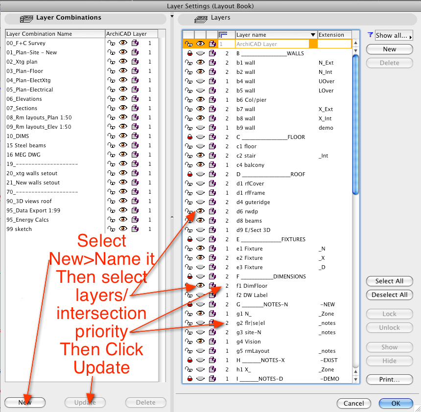

Read page 28 ArchiCAD 12 Reference Guide.
See attached to get you started.

Another way is to select a layer on the right and set the Visible/Not Visible icon to Visible for each Layer Combination you want that Layer to be visible in.
