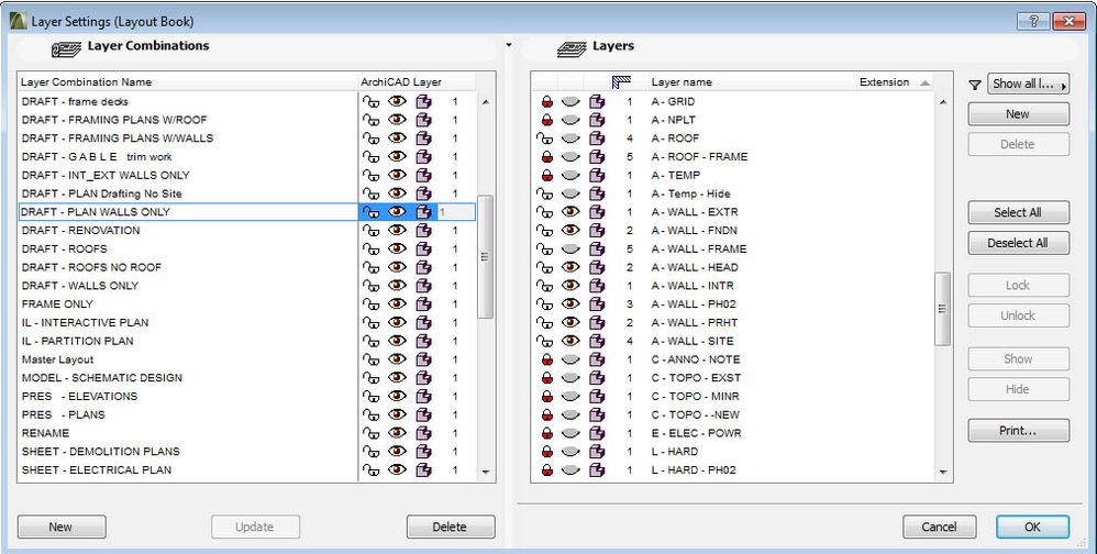

Try following a standard for your layer names, it will help in the long run.  Use the search function near the top of this page and search for NCS Layers, you'll find some help there.
I've been using my interpretation of the  AIA CAD Layer Guidelines for a while, it is a tree part system consisting of:
1) A one letter discipline code: A=Arch, S=Struc, etc
2) The group type or element descriptor, use enough characters to make remembering easy: WALLS, SHELL, or TOPO
3) You can have a third group for greater refinements: PARTIAL, SOFFITS, NOTES, AREA, PHASE2, etc
The following screen shot shows you some examples.  Good layer naming allows you to create multiple layer combinations settings for specialized work.  Notice how I use the combinations to isolate roof framing, wall framing, gable and eave trim work, etc.  Of special interest is the DRAFT - ROOFS - NO ROOF combination:  I use this type of combination to view all the roof accessories, parapet walls, etc without the distraction of the quite complex roof forms in use on my projects.  The example is a result of my usage over the years, but I hope this gives you some ideas.
