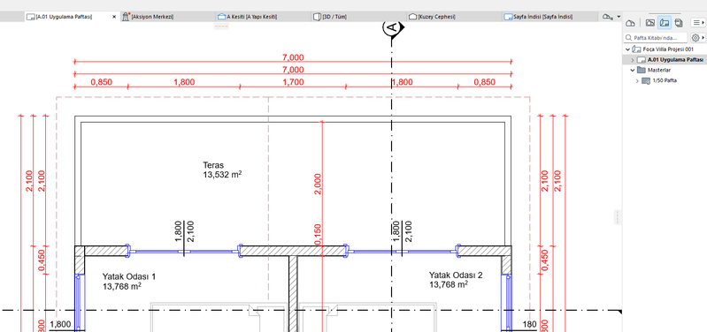

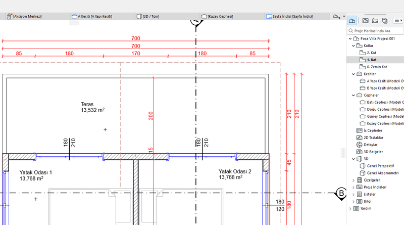

In Archicad, the measurement unit of the dimension lines is centimeter, but in my master sheet these measurement units are converted to meters. How can I show them as centimeters? 

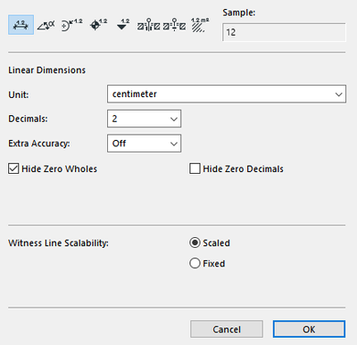

You need to create a new dimensioning type. Go to Options - Project preferences Dimensions
There you can set everything up as you want them to have, and then, you can Store them with your own naming.
ex:
This can be accessed by the menu you showed in your screenshot.

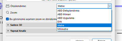

edit: I now understood your question: Check the placed view from the view map (right click on it and go to settings) and view  check the dimensioning settings
yes i checked here but only meters and millimeters are available. there is no option to convert to centimeters. how can i do that?
ex:
Thank you very much, I solved the problem thanks to you
