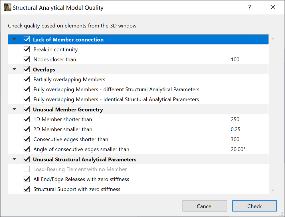

Structural Analytical Model Quality Check
This function ensures that the automatically generated Structural Analytical Model is correct and ready for exporting to a structural analysis application. (The Desing > Model Check > Structural Analytical Model Quality... command is only active when the structural analytical model is displayed.)
In the Structural Analytical Model Quality dialog you can find checking rules specific for the structural analytical model. You can select which of these checks you want to run by checking its box. Some of the rules have values you can customize to conform to modeling standards, or software or project rules.
When you have finished selecting and setting up the rules, hit the Check button to run the Structural Analytical Model Quality Check.

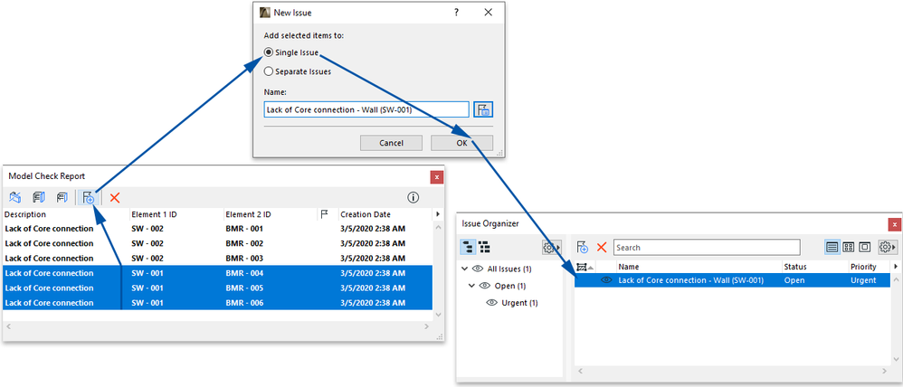

Model Check Report
After model checking has run, the Model Check Report opens automatically. It provides straightforward management of reported problems from all three of the model checking functions, in a single list. You can easily zoom to the problematic item.
Issue Management
Decide which cases are genuine problems that require handling. These can be easily turned into highlight-type issues directly from the Model Check Report dialog:
  • Create a separate issue for certain reported items, or
  • Create a single issue from multiple reported items
Read more about Issue Management in this article.
