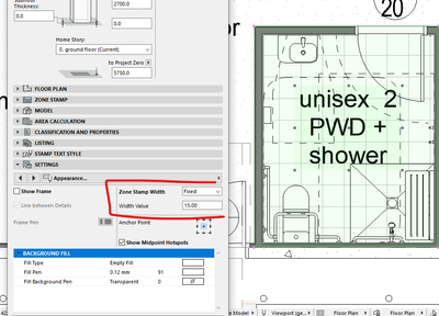

if you are using an earlier AC version (pre-25) you can change the length of the field name by setting the Zone Stamp Width to "Fixed" & adjusting the Width Value:

Solution
Gerry Leonor

Thanks Gerry! This worked for me even though I'm using AC25 v4013
