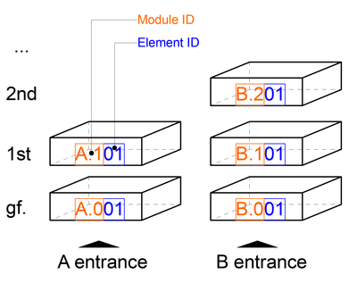

I don't think it's a problem. You may need to enter the ID differently. For example:

Turit
We use the ID instead of the room number. Thus, the module id and the element ID together give the "numbering" of the room.
ID is ok, but more than often we have more entrances inside bulding( for example Entrance A, aprt 101, Entrance B apt 101..) And therefore  we use ID for grouping the apartmens by entrances. That's why I am curious to know is ut possible to override the properties inside the host file

Solution
ArchiMind
I will have this in mind, but it’s not giving me the answers is it possible to override properties of module in host file. 🙂

Don't forget modules have a 'Master ID' that you can set as you place the module or can edit afterwards.
You may be able to use the Master ID in conjunction with the element ID and properties.

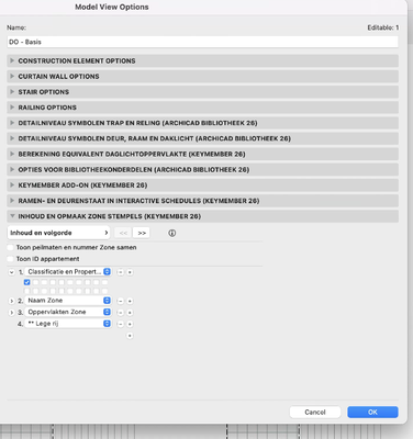

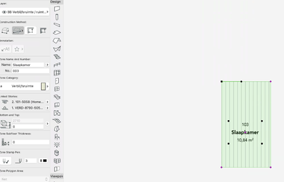

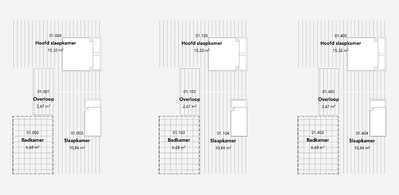

Hello Archimind,
I made a property in the zones that looks at the Hotlink Master ID, and adds that value to the zone number. I combine the text with the zone number plus it automatically adds the floor number (the 01), it combines it with a '.' you can ofcourse also add these values yo each other. In my example I add the number from the master ID to the zone number .
And show it using the Model view

So in this example, the two floor plans on the right are modules, but you can still manipulate the properties in it, so no manual texts or labels, and if the zone changes in the module,
You can make a property do this: it looks at the home story number multiplies it with 100 and then add your zone number. So there are alot of different ways to do this, it does this automatically and also in a hotlinked module 😄
