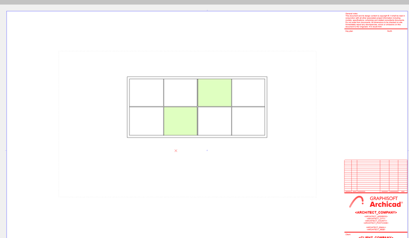

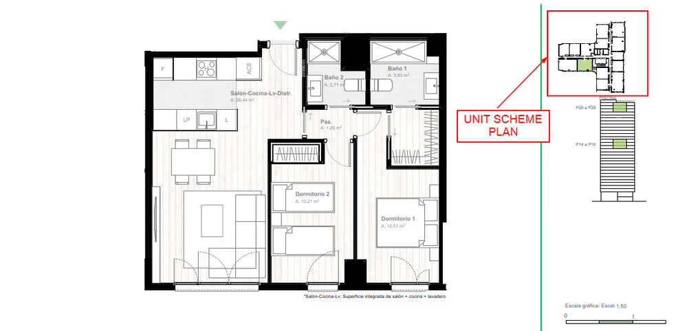

Hi!
I have to assemble the commercial plans of all the dwellings in a building. I would like to include in each layout a unit scheme plan but colouring only the unit that corresponds to the layout.
As there are many unit types, my intention is not to have to create a lot of combinations of graphic overlays to colour  every single unit type.
I also want to avoid drawing a manual fill on top of a base plan.
I had thought about one graphical overwrite depending on a property of the layout, but they are not accessible.
Any idea?Commercial unit type.png?

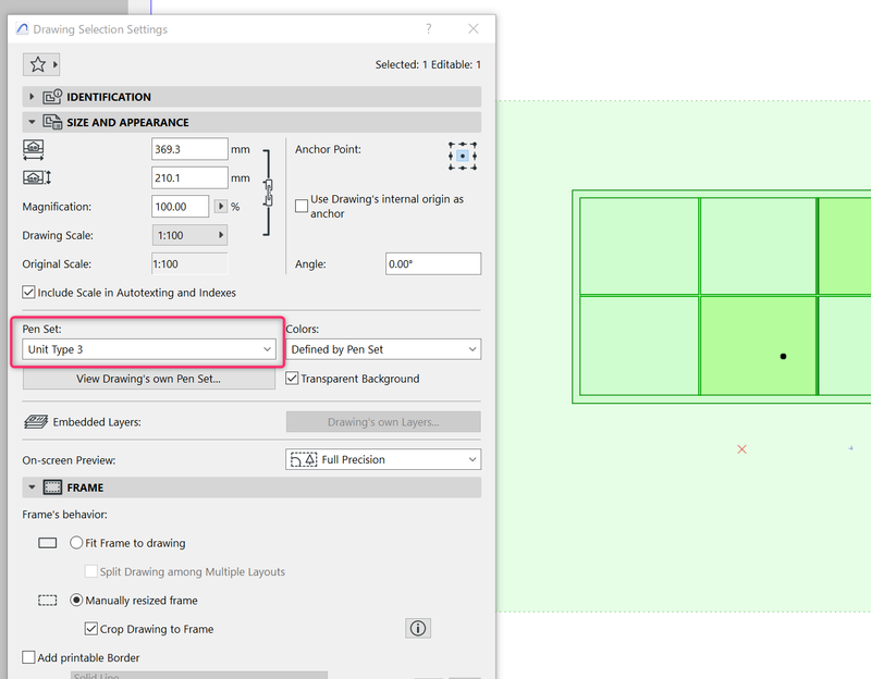

If you don't intend to show the zone category colors on the plans then you can use the zone fill colors and pen set to switch room colors in each layout.
First, you create pen set for each unit type.
In the zone settings, turn on the the cover fill and select Solid fill color (25%) and set the cover fill pen to pen number applicable to the unit type.
Then create a GOR to turn everything black lines and empty fills except for zones.
In the layout, select the pen set in the drawing settings to switch the unit types.

Good trick. It implies visualizing different zone colors for same categories when not applying GO, but I think it's better than managing GO.
Thanks for your detailed explanation.
