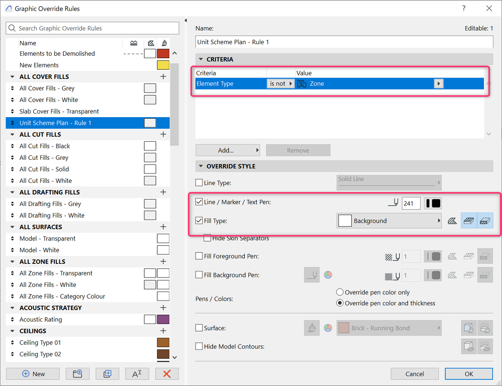

If you don't intend to show the zone category colors on the plans then you can use the zone fill colors and pen set to switch room colors in each layout.
First, you create pen set for each unit type.
In the zone settings, turn on the the cover fill and select Solid fill color (25%) and set the cover fill pen to pen number applicable to the unit type.
Then create a GOR to turn everything black lines and empty fills except for zones.
In the layout, select the pen set in the drawing settings to switch the unit types.

Good trick. It implies visualizing different zone colors for same categories when not applying GO, but I think it's better than managing GO.
Thanks for your detailed explanation.
