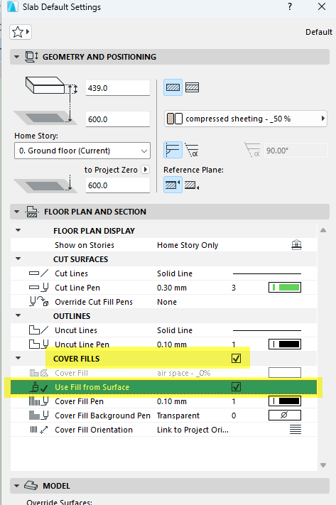

By default a slab will not show a fill in plan.
But in the slab settings you can turn the cover fill on.
You can set any fill you want or set it to use the fill defined in the surface material.

Thank you so much . This is what i want and sorry for my noobie.
