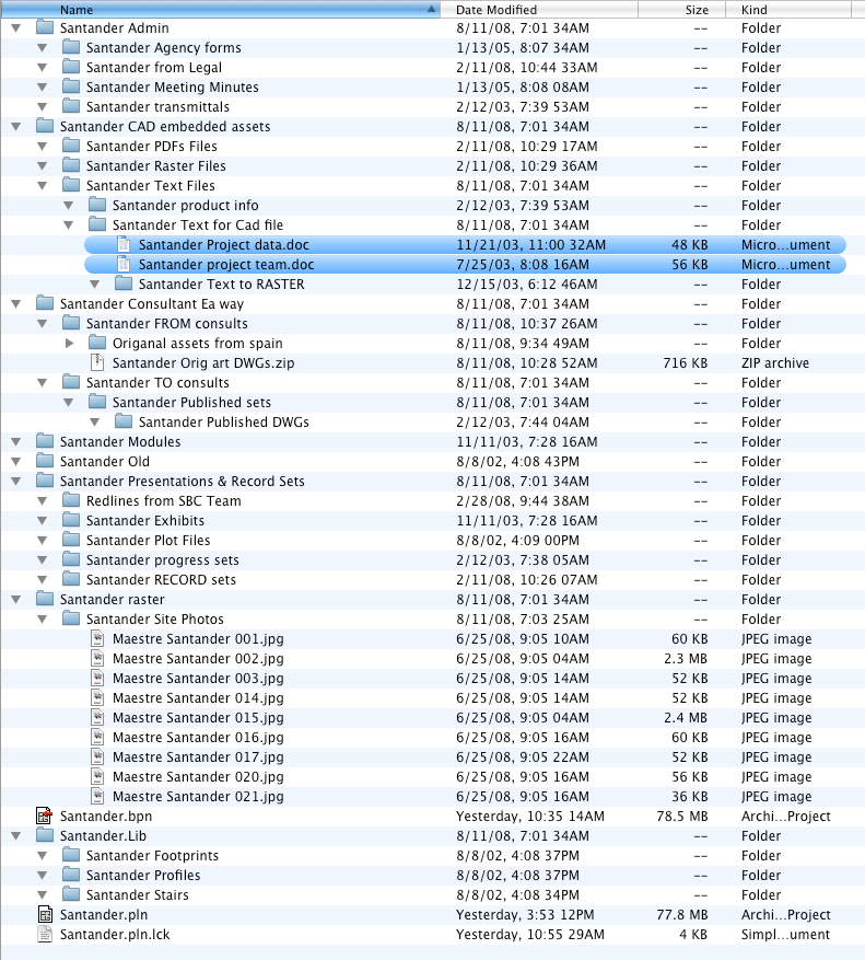

One piece of advice that you probably already know: make an office standard project directory (with all the folders you want) and leave it someplace safe, maybe with a zipped backup. Then every place where the project name or number appears in the directory structure, tag it with a word like "JOBNAME" or something. Then copy your directory as you get new projects and use a utility (on the Mac I use something called R-Name but there are lots on both platforms) to automatically replace JOBNAME with the actual job name. I always leave the current PLN file at the root level (ie top level) of the project directory.
Here's what my Project directory looks like for a project I just started in Spain:
Nattering nabob of negativism
2023 MBP M2 Max 32GM. MaxOS-Current

Hello,
Whatever your platform or renaming method might be;
Having the project ID in the names of the sub directories makes
all renaming a lot more difficult than having the ID just in the file names.
It is very difficult to find and rename stuff where the paths change all the time by the renaming process itself
In addition relative linking inside the project benefits greatly of having
identical subfolders between projects.
Regards, Juha
