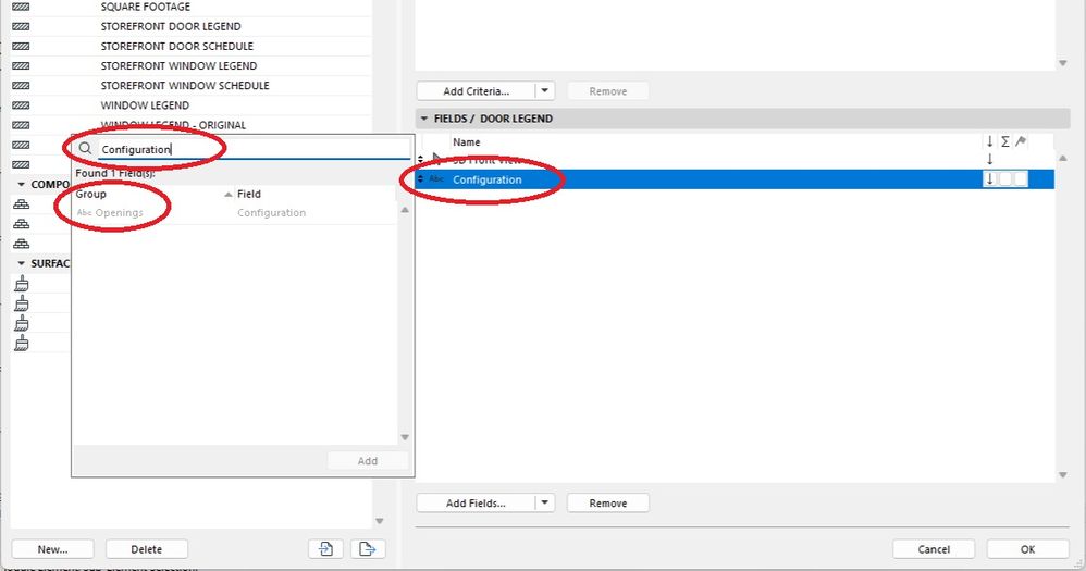

Yes, if you want to quickly find out what group the property came from, you can use the search bar at the top of the Add Criteria/Add Fields dialog box by typing in the name of the property.  It will tell you what group it is located in.
