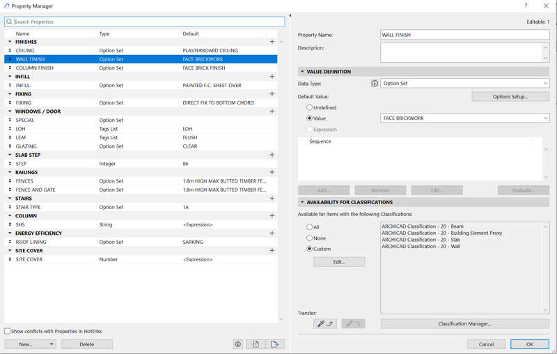

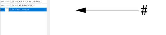

I've set up a lot of property manager values to make notation easier. However, I've found that even if the values themselves have been imported into a file, the favourite with that autotext value will be broken. Is there a way to get this linking correctly?

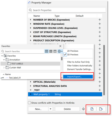

Hi @KatherineC97
Try to export favorites as .prf and properties as .xml from Favorites palette and Property Manager settings and then import both files in the new project.
I have just test it and it worked OK.
Regards.
