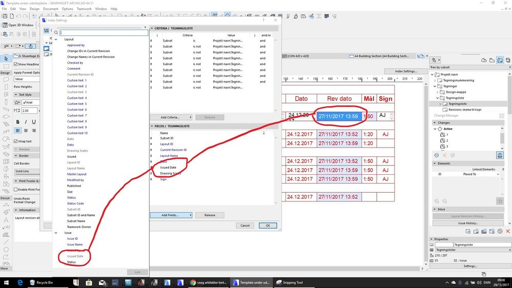

Hi guys.
When placing the field "Issued date" in an index the value will be showed as both date and time...
Example: "27/11/2017 13:59"
Anyway to edit this field so it will only show the date...
Workaroaunds will do as long as they´re automatically linked to the actual "Issued date"
Any tips or tricks will be appreciated.
Cheers
15 Replies 15

Hi Guys.
Thx´s for the fast replies. The index is to be used in a company template, meaning everything has to automated, ,and no one should have to o and type the date manually, it all has to be BIM Smart, hence no personal could make the mistake of (not) typing the correct issued date when publishing revised drawings..
However shrinking column could a workaround...
Thanks for the input guys
