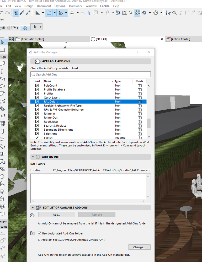

I want to import RAL colors to my workspace, preferably as surfaces or penset.
I have tried to download 'Goodies' add-on as explained via this link: https://community.graphisoft.com/t5/Project-data-BIM/RAL-Color-System-Add-On/ta-p/303650 - but it didn't seem to work. I can see it in my add-on manager, but I can't import the RAL colors.
There is a disclaimer on the download site: Disclaimer: Goodies are free Add-Ons developed by GRAPHISOFT to complete ARCHICAD with specific abilities and features. As of ARCHICAD 20, you can install all Goodies at once with the help of the ARCHICAD Goodies Suite installer. They are based on legacy code which GRAPHISOFT does not support anymore. Feel free to use them but please be advised that they might not function properly and they will not be fixed or upgraded.
Can this be the issue? that is no longer supported?
Can I download and import RAL colors any other way?

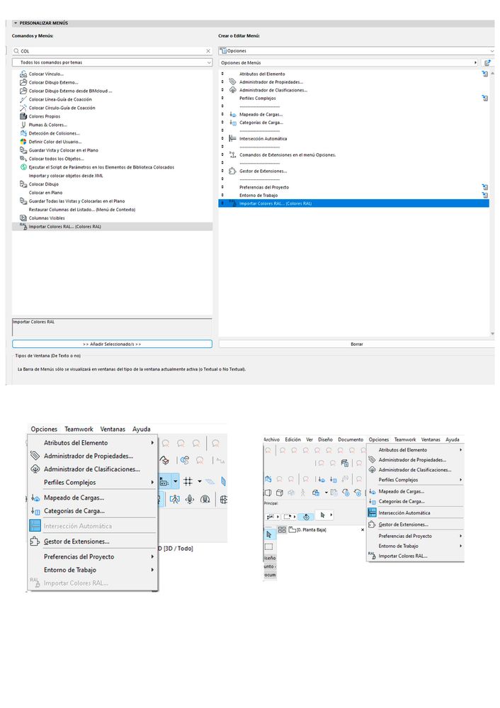

Hi
Goodies don't add themself in the menus automatically. You have to search for them in work environment/menus and add them manually.
Regards
Gorazd Rajh
From AC 6.5 onward, i9-14900HX, 32 GB RAM, RTX 4060, Win 11
RalphM
Write COL in the search engine of work environment// menus// and add to options menus. For other hand you must work in 2d window for activate the line,
