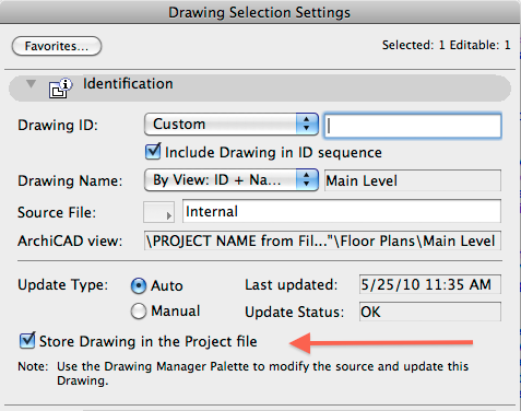

And yet another save space thing is to clear the checkbox for "Store Drawing in the Project File" in the Drawing settings for each placed drawing (and the Tool itself for subsequent drawings). See attached.
