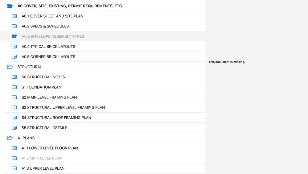

Hi All,
When uploading projects to BimCloud and viewing on the BimX iphone and ipad app, we have been getting random sheets and views showing up grayed out with the error message: "This document is missing." Each time the project is uploaded different sheets are missing, but if I open the BimX file on my desktop the sheets are there with no issues. Smaller projects seem to upload fine, but I haven't done enough testing to determine what size file is problematic.
I've been noticing this issue for the last 4 weeks or so and is happening with multiple different projects and computers.
ETA - this AC file is 200MB and the BimX file is roughly the same
We're on Mac M1 Max Sequoia 15.7.5
AC 29.1.0 (4002)
Operating system used: Mac Apple Silicon Sequoia 15.7.5
Solved! Go to Solution.
2026-06-02 06:15 PM
Just wanted to update that this got resolved by Graphisoft on the backend
2026-05-08 06:00 PM - edited 2026-05-11 04:52 PM
Slight bit of further information - This appears to be an issue with the iphone/ipad app. Views/sheets that appear missing in the app are correct and viewable in the browser version.
2026-05-10 07:41 PM
You should report this issue to your local support.
2026-06-02 06:15 PM
