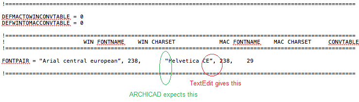

A few more things to pay attention to:
  • Having done the necessary modifications, please save the file using ANSI coding on Windows and Western (Mac Roman) on Macintosh.
  • The file XReadCfg.txt has to be edited before starting ARCHICAD.
  • Now you can replace Eastern European character sets with Western European character sets as well, so the replacement became easier.
  • In the lines of FONTPAIRs parameters have to be separated by commas.
  • Please use the type of quotation marks shown on the image below:
