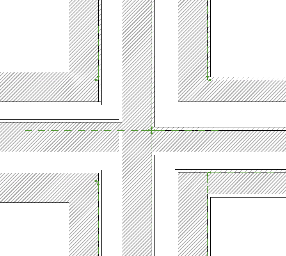

I now post another image, and this one is a direct screenshot of my project. The green arrows show the start and end of my walls. And once I again I'm having trouble eliminating that pesky interwall noise.
Care to take a shot?
I think the picture explains how it works.
Basically you need all the reference lines to join.
A corner wall may trim beyond the length of the reference lines but the wall is not really there in the corner.
That's why no other wall can trim to it properly (see second image).
Same image with auto wall and beam intersections turned off.
See how there is really no wall in the corner so you are not really trimming to anything.

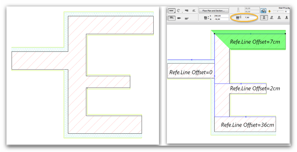

Once again you solved it! Though... (!)
Duplicate the Profile or Composite while changing the reference line to some other place which is more convenient regarding the intersection we have to solve:
This seems like a totally inelegant solution, and not ver BIM. It forces me to have different profiles for exactly the same type of wall, which will make it harder for calculations, Find & Select, etc.
During my experiments, I understood that making all the reference lines collinear would solve the problem, but that would force me to duplicate profiles/composites. I would really like that this discussion could have a happier ending!
You do not need to duplicate composite walls. Just increase or decrease value for the reference line offset.
Works as advertised. Offsetting the reference line per wall is certainly a much more elegant soution than duplicating attributes. I don't love it though.
