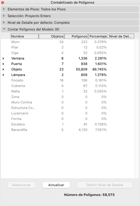

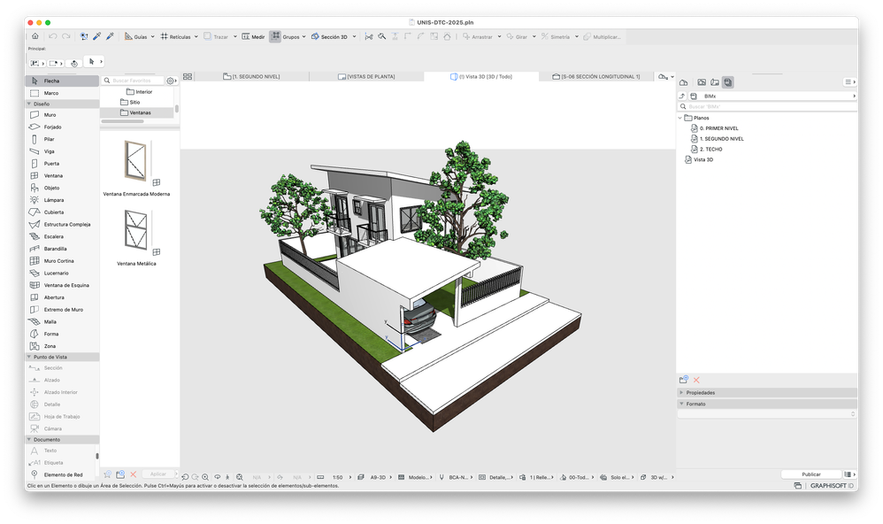

I’m running into some persistent lag with Archicad 28 and was hoping for some advice. Whenever I make a change in the floor plan and then switch to the 3D view, the refresh is slow and can take between 3 to 5 seconds before I can smoothly orbit or pan. This happens even with a basic, white model—no composites or complex materials. (attached is a reference view of the model and an SC of the polycount tool)

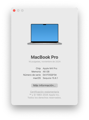

My setup: latest version of Sequoia on Macbook Pro 16", M4PRO chip, 48GB RAM, default work environment, and background processing enabled in AC28. - 28.2.2 (5200) SPA Full (arm64)
Has anyone experienced similar slowdowns, or does anyone have tips to speed up the 3D view refresh?

I’ve been experiencing extreme lagging since the 28.3.0 upgrade. However, if I click on Hardware Acceleration and then the 3D icon to open a new window there is no problem. It’s a workaround and not a very good one, because if I  make any edit, I need to close the 3D window, click on Hardware Acceleration and then click on the 3D icon to open a new window. Pan and orbit are both fine – until you make an edit in either 3D or plan. I’m just sharing this information in case it might help solve the problem faster.
