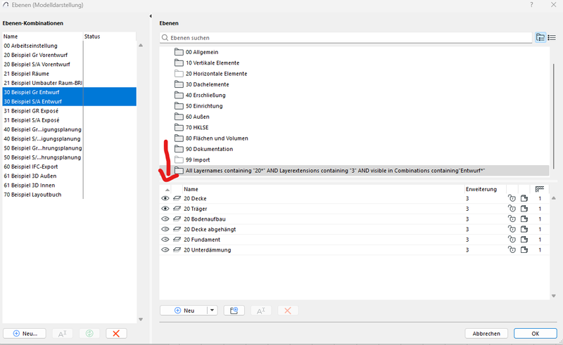

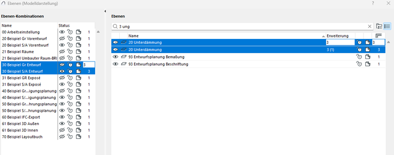

Thank you  @Francois Swanepoel I'm aware of those (arguably great features, compared to before).
But I still have to edit my Layer Combinations manually. For each new Layer I create, I have to go through all existing Combinations deciding on their "status". And I'm the guy, who will notate a layers intersection group in the extension, fixing it conceptually for all combinations. I cannot imagine colleagues, who assign different intersection groups for different combinations individually ...
With only a few Layers and Combinations one can do this the OLD way:
But there is a reason Archicad has introduced those folders in order to sort through oodles Layers.
Now imagine me with hundred combinations to perhaps thousand (imported) layers with a complex nomenclature. Introducing a NEW Layer is tricky and prone to errors.
"Duplicate Layer" is a great feature when simply differentiating existing conceptual structures.
And YES the search does work well with extensions.
But why remember cumbersome search criteria, when those Layer FOLDERS could also be saved search queries:
Contain all Layers with layer names "20*" AND Layer extensions "*3*" AND visible in all Combinations "*Entwurf*".
Thus creating a concise simple overview of what I need to now/check.
Off topic: "Layer" is accessible to expressions and thus to IFC. (Top feature, totally underappreciated)
Why not also grant access to Layer Combination names?
