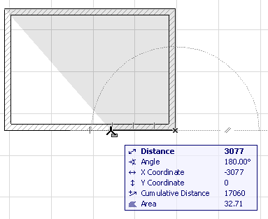

Measure Distance and Area
Shortcut: M The Measure Tool is usually used for measuring distances between two points. But with two or more clicks, the Tracker also shows the cumulative distance and area.

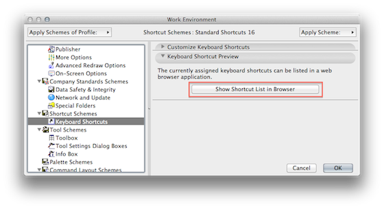

The entire list of all ARCHICAD commands is available within ARCHICAD: Options/ Work Environment/ Keyboard Shortcuts
