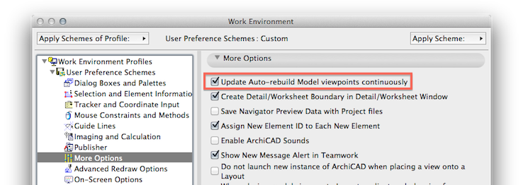

  • Trace reference on/off
  • viewpoint or view as Trace reference?
  • try switching off palettes (navigator, navigator preview, info box)

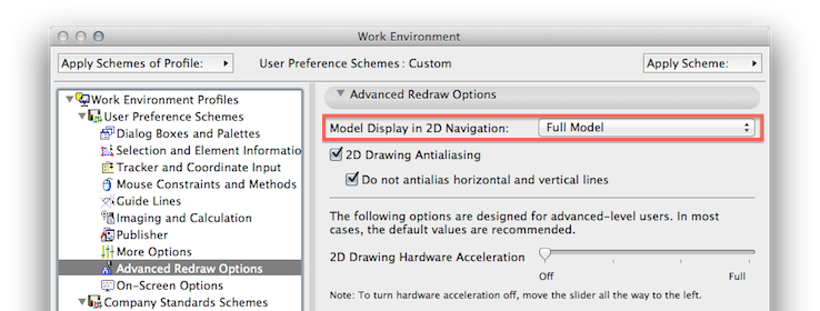

  • "Model Display in 2D Navigation" WorkEnvironment setting

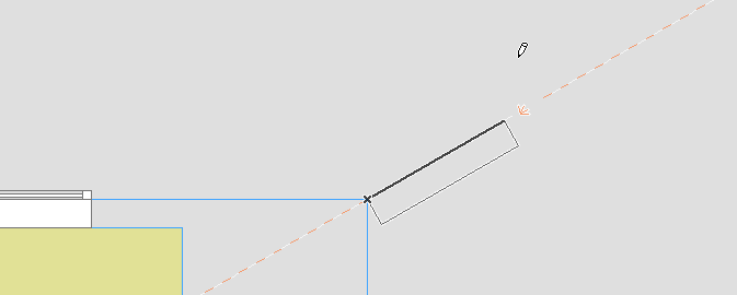

  • Feedback is slow. By feedback we mean all the temporary visual items that appear during the process of element editing, e.g. the ghost elements that follow the cursor when you drag something, or the rubberband that follows your cursor while drawing a wall.
It is important to differentiate between rebuild and feedback related performance problems, since they usually have a different cause.
    typical feedback problem: rubber band not following the cursor

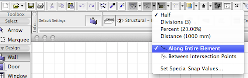

Special Snap Points Setting
It might happen that your plan has many lines with many intersection. If you have the Snap Points setting set to Between Intersection Points, it might slow down the pre/selection. If you not some feedback slowness, try to change the Special Snap Points setting first to Along Entire Element.

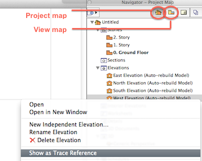

The use of View map items as Trace Reference
If you wish to use e.g. an elevation as Trace Reference under your floor plan, you can do it in two ways:
  • Select the elevation in the navigator’s Project Map, and select “show as Trace Reference”
  • Select the elevation in the navigator’s View Map, and select “show as Trace Reference”
In the first case, the Trace Reference will use the same layer settings and model view options as the active view. In the second case, the Trace Reference and the floor plan will use different layer settings and model view options. This latter scenario will result in a much slower 2D rebuild, because the refreshing of the Trace Reference involves changing layer and model view states. So, if possible, use Project Map items instead of View Map items as Trace Reference. Using a Trace Reference that has a different Dimension Style setting than the active view causes even worse performance problems, since due to technical causes changing dimension style between views is a fairly slow process. Make sure dimension styles (which technically can be different in every view) are uniform across all views in the project, if possible.
