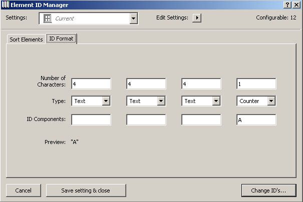

Look at the attached screenshots. Is this what you need?
Step 2: "ID Format"
Result!
