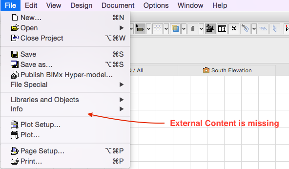

The External Content Menu is missing from the File menu in ARCHICAD 19 Solo edition
Issue
The External Content menu is missing from the File menu therefore the Place External Drawing command and the Drawing Manager menu is also missing from the default Work Environment.
Solution
Workaround: The Drawing Manager can be accesed from the Navigator or the Organizer.

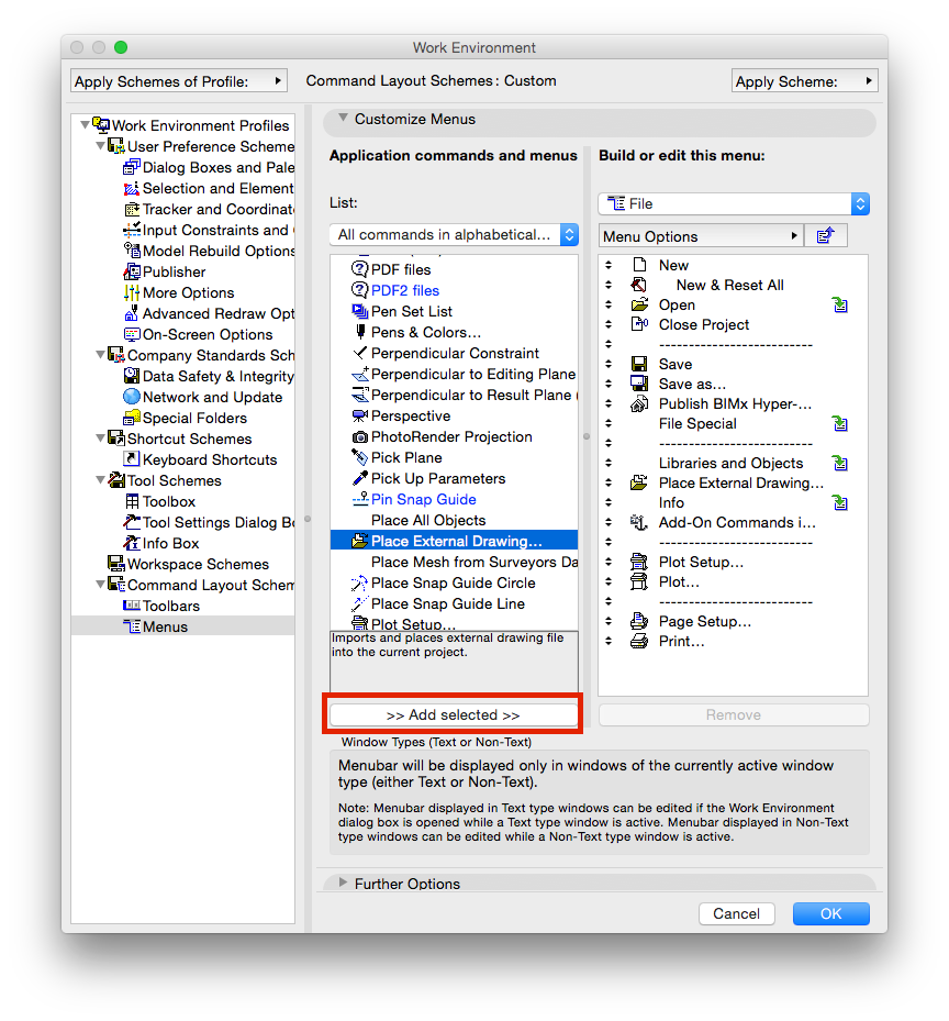

The Place External Drawing command can be placed in the File menu or any other menu through the Options - Work Envrionment - Menus dialog.

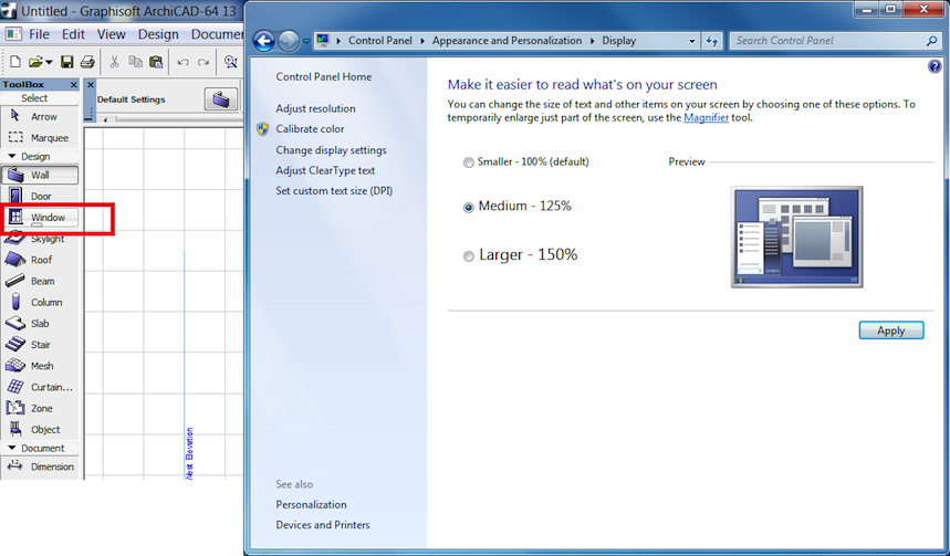

Tooltips are missing
Issue
Tooltips are missing, only a small rectangle is represented when holding the cursor over a button of a palette.
Cause
With custom DPI settings the tooltips aren't handled well.
Solution
To fix the tooltips set back the default DPI settings in Windows.
  • Open Control Panel/Appearance and Personalization/Display
  • Set back to default (100%) the value at Make it easier to read what's on your screen
