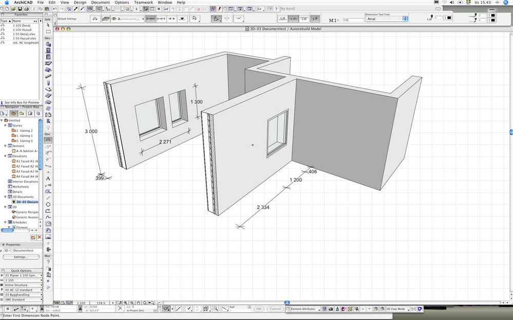

Mats_Knutsson
Mentor
Here is my AC12 beta WE.
Mats
