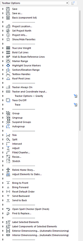

For my staff, I made a custom toolbar that includes that, and a lot of other useful things...

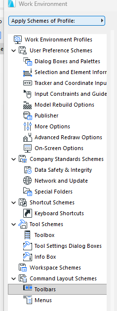

To set up a custom toolbar...

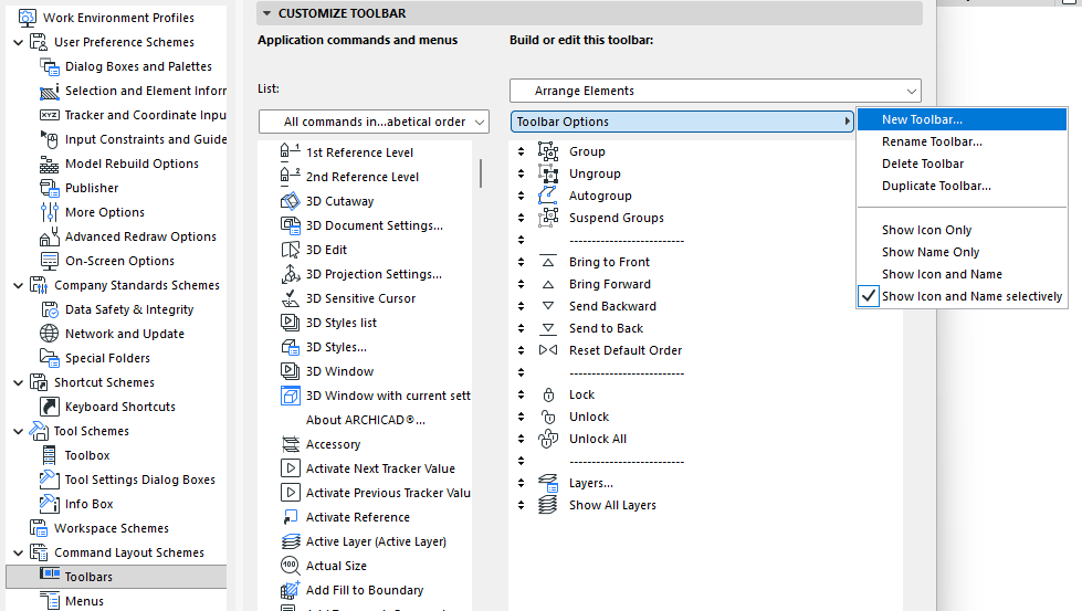

Go to Work environment->Command Layout Schemes-> Toolbars
Go to Toolbar Options->New Toolbar
In the list in the middle find the commands/buttons you want to add...

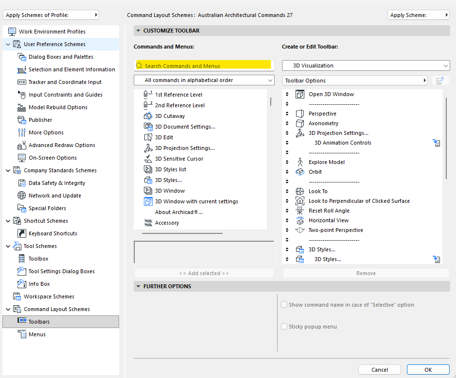

In older versions you click in the middle list and type, in Archicad 27 and above you can use the search field.
The hardest part is knowing the names of the commands/buttons you want to add.
You see you can also add menu groups as well.
In the example below tracker options - Gravity and  Trace are menus with sub commands.

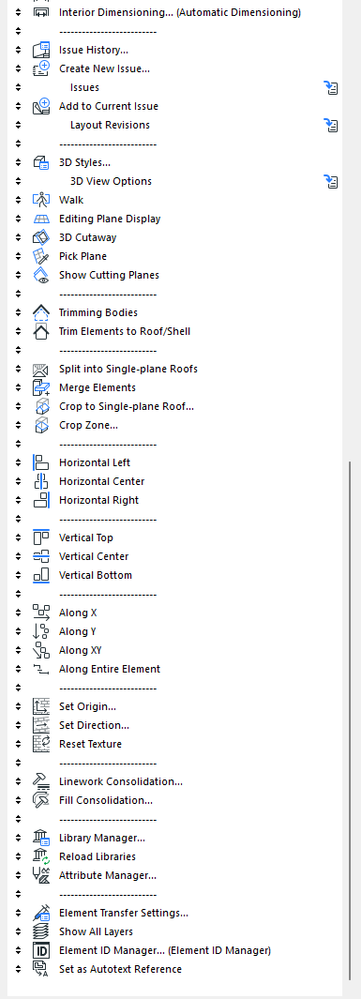

The menu shown above was for a 1920 wide screen(compact) when using laptops or doing presentations,
The example below is for a 2560 wide screen,  so there are more options in the list below.
For me I added....

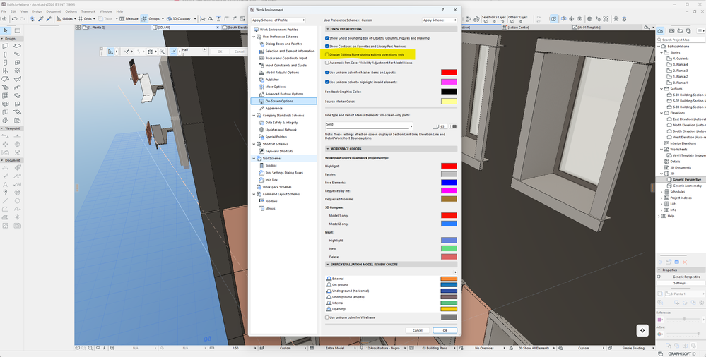

Don't need to teach me about workspaces. I have my own with my own palettes and shorcuts. Didn't implement it in the english beta version because don't want to drag old things into the new interface. But never realized that something so deeply buried into the work environment would be available as a command.
My workspace. There are some scattered buttons here and there....
