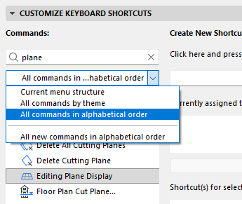

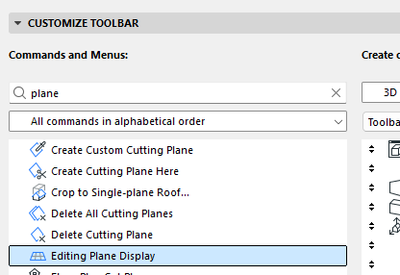

It's already there?!
Or am I missing anything?
You can assign a keyboard shortcut for it, too.
Yes, the command is called "Editing Plane Display" and it is already available in the View menu. You can also assign keyboard shortcut to it in the Work Environment.
