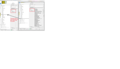

The program is really cool, unfortunately it cannot be used for renaming classifications because it does not preserve attached properties, and the IFC converter converts all classifications to ElementProxy. However, it is an excellent tool for creating a completely new classification system. Thank you and your brother 🙂

I noticed in your Screenshot that you put the class name in the ID field, you work like that, i guess that's a classification system you build your self.
I suggest you to take theese notes in consideration and try if it works for you :
  • ArchiCAD uses the ID field to match between a class and selected properties,
  • also, the ID field can't receive an duplicated value in the same classification system , Exp : you can't set the ID to "wall" in two branches.
  • if you set an ID system for your classification ( numbered tree ) and put your classes in the name field, then , when you rename your classes you won't loose the connection to properties,
  • only the branches where the ID changes will loose the connection to propreties, because archicad won't recognize that NEW ID in the XML file, to match it to the properties that have the OLD ID
that's why you loose your connections to properties,
the general rule is : Fixed ID, modifiable name.

It is actually original Czech version of Archicad 22 and 2.0 classification system. I noticed that your xlsx looks different, but I didnt realized this could be the problem. It explains a lot of issues I've been having past week 😄
