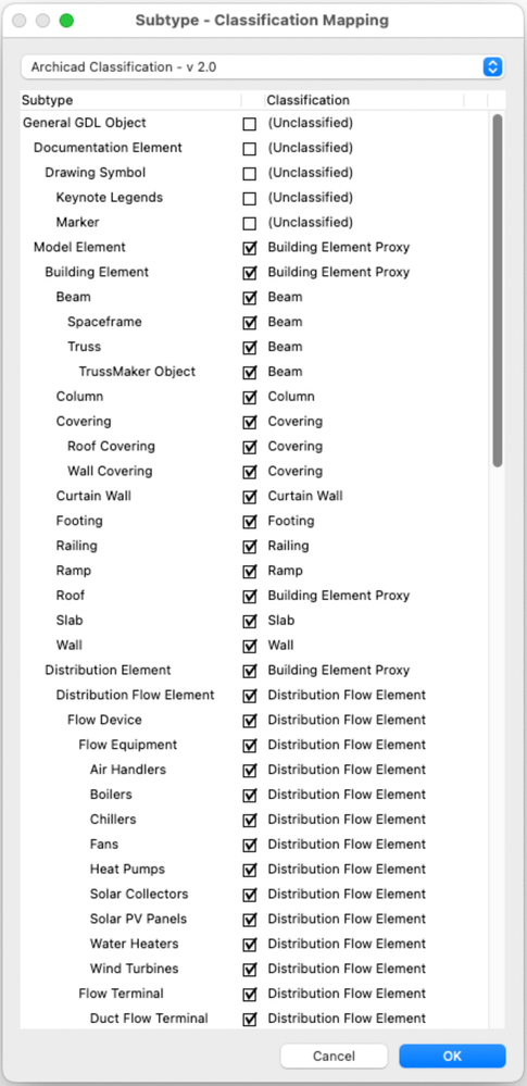

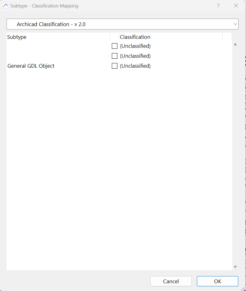

My template is not automatically assigning a default classficiaiton for modelled elements. I've looked at past posts and have found the 'Edit GDL Library Parts' Toolbar and the 'Subtype - Classification Mapping' window but it doesn't show all the classifciations that can be ticked a align assignments. See images of what I was expecting from forums v what I am seeing. I've tried re importing ArchiCAD Classification 2.0 but no change - when I look at the classificaiton manager it has all the classifications I would expect.

So, if I understand correctly, the top image is what you expect, and the bottom image is what you actually see in your Template file?

Dan Smedley
Correct
Our own template but started from an ArchiCAD Template a few versions ago so we've done something while changing the template
Yes Libraries loaded.
