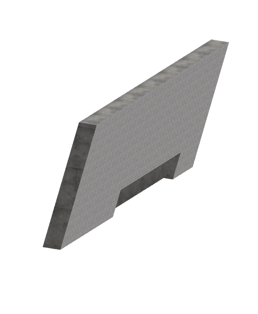

ok guys heres the deal:
we have two walls one (a) straight 150cm high, second (b) 340cm high inclined (80degree angle), using solid element operations i sub (a) from (b)... i get this in 3d and section: (pic 1, 2 and 3) which is fine, but i cant seem to fin a way to make it visible in plan view (pic 4) 😕 (btw the wall (a) is on a hidden layer)
im running ac13edu on a mac... latest built, dowloaded yesterday

I've thought of an alternative method you could use.
Capture the profile of the sloped wall to use as a complex profile. Edit the Profile to create the void within the wall and save it. Now split your existing wall on plan into three giving the middle section of wall the same length as you want the void to be. Apply the complex profile to the middle section of wall. Unfortunately you will have to draw the lines that form the edges of the void on plan, but other than that it works well on plan, section and elevation, and will also display correctly according to the floor plan cut plane.
Hope that helps.
i actually thought of a same thing in this particular case - complex profiels, with more simple one, i can achieve that without cp thanks man btw do you know any good sites with ac tutorials?
