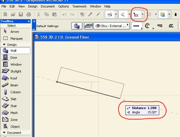

Drawing walls, I can find fields to adjust every single possible attribute imaginable apart from the actual length of the thing! Clearly I am stupid (or this interface is).
Where is this field? How can I drag to extend or alter the length of a wall numerically?
Thankyou.

Hi Richard,
From your background of using Illustrator, of course you are going to find that ArchiCAD works slightly differently. ArchiCAD is a pretty complicated program and is difficult to master just by trial and error. To save yourself heaps of time (and your sanity!) get a regular user to show you the basics, rather than trying to guess. Also work your way through the Interactive Training Guides here, as these will answer many basic questions.
The length isn't a parameter you will find in the settings dialog box. Your problem is that you probably haven't turned on the tracker, as this displays the length of the element on plan and allows you to easily change it. Turn it on using the button circled at the top.
Select the node at one end of the wall, then simply enter the length and hit return.
