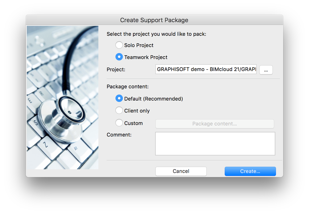

How to create a Support Package
  1. Reproduce the issue in Archicad.
  2. Go to the Help menu > Create Support Package.
  3. Select the affected solo (PLN) or Teamwork project you want to capture.
  4. Select the package content to be sent. Default (Recommended) - Use this option if not instructed otherwise. Client only - This option excludes the logs and project data from the server and includes only the client-side data. Use this option if the server cannot be accessed properly or if you need to limit the size of the package. Custom - Use the Package Content button to set the content of the package. The optional content differs for solo (PLN) and for Teamwork projects. Use this option only if you are instructed to do so.
  5. Describe the nature of the issue in the Comment box.
  6. Hit Create and select a folder where you want to save the package to.
