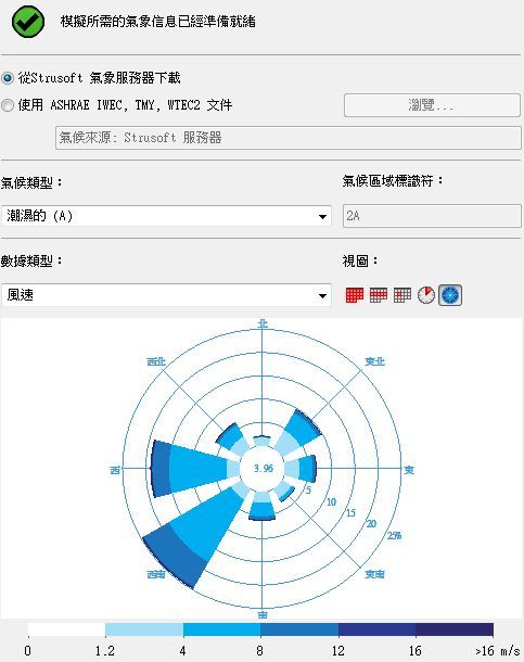

What is the TMY files (*. Csv)?
Because Automatic download of climate information is incorrect,
I want to use this format input climate information, thanks.

Correct Wind roses chart

Because Taipei is a basin topography,
I think sometimes the climate affected by topography, wind direction will change.
Thanks for your help.
I found the taipei.tm2, please refer to the attached file.
It can work properly, the problem has been resolved.
Correct Wind roses chart Generated by ENERGY EVALUATION IN ARCHICAD 17.
