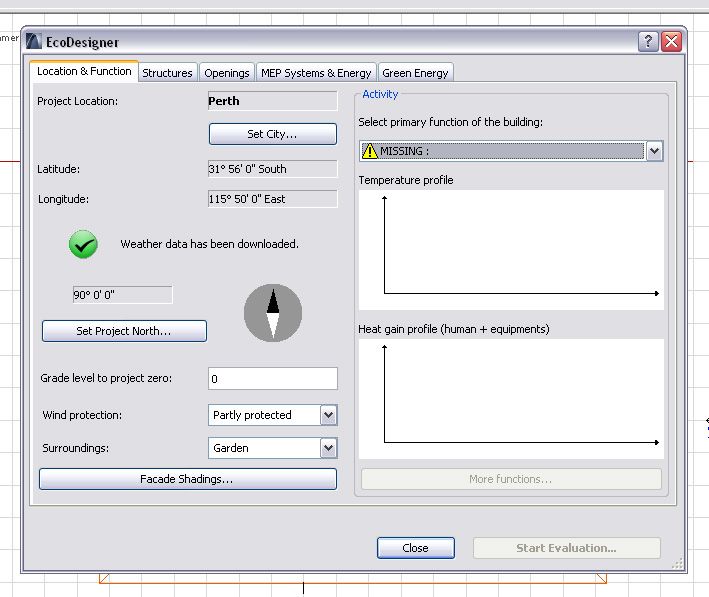

Hi!
I am trying to use ECO designer for the first time, but when I try to scroll the activities list on the first page of ECO designer a yellow triangle with expression mark appears and it says MISSING.
I have looked into the XML files in the Addon folder and they appear to be in order.
I did however install AC in a non default folder due to prior installation issues. But I have no problem loading either weather data or installation lists. Could this cause the problem?
Grateful for all help I could possibly get!

It is possible that your non-standard installation location is the problem - perhaps all of the ED data was not installed because of that, or ED cannot find it.
Look inside your ArchiCAD program folder > Add-Ons > EcoDesigner. You should see the attached. The usage info and more is stored in one of the localized folders. If they are all there, and each folder has 6 XML files in it, then EcoDesigner may have an issue with finding those folders if AC has not been installed in the standard location.

Thank you for the reply!
I found the problem, I was trying to use the INT ED with SWE AC... Although I do not understand how that could have been the problem or not it solved it self once I found the SWE ED version.
