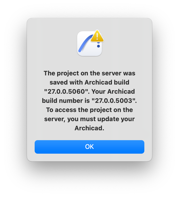

Contrary to what Graphisoft have said about compatibility between files made with the same Build series - e.g. 5xxx, I've discovered that the files I shared from build 5060 are not openable with the workstations in the office running 5030.
The only files affected are Teamwork files I share from 5060. PLNs are unaffected.
I ONLY installed 5060 to evaluate how it affected performance. If I had known this would happen I would have NOT installed it.

We had the same issue today with an Intel iMac that hasn't been updated.  However, an M2 Mac Studio running AC27 - 5030 can join just fine.  After updating the iMac, it could join the teamwork file.
