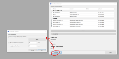

AC-24.0.0 and L-5 folders create themselves every day when I run Archicad ??
So, I changed something by The Local Data Manager (Teamwork> Project> Local Data Manager) and since then every day when I start Archicad a new folder is created with these two (AC-24.0.0 and L-5) empty subfolders inside. 😤
If anyone knows how to keep these folders from appearing to me again, please inform me. 😊
Thanks in advance.

I assume you modified where the local cache of Archicad Teamwork should be stored on your computer. When you start Archicad it searches for all the needed folders and see it is missing from the given path, therefore recreates it.
You can set again the default path (C:\Users\<username>\GRAPHISOFT\TW Data), so you won't see these folders, but it is not possible to get rid of them fully.

This is where you likely modified the path:

Hi Noémi and thank you very much!!
It's not actually a problem but it can be annoying when it happens every day.
So thank you again and have a nice day.
