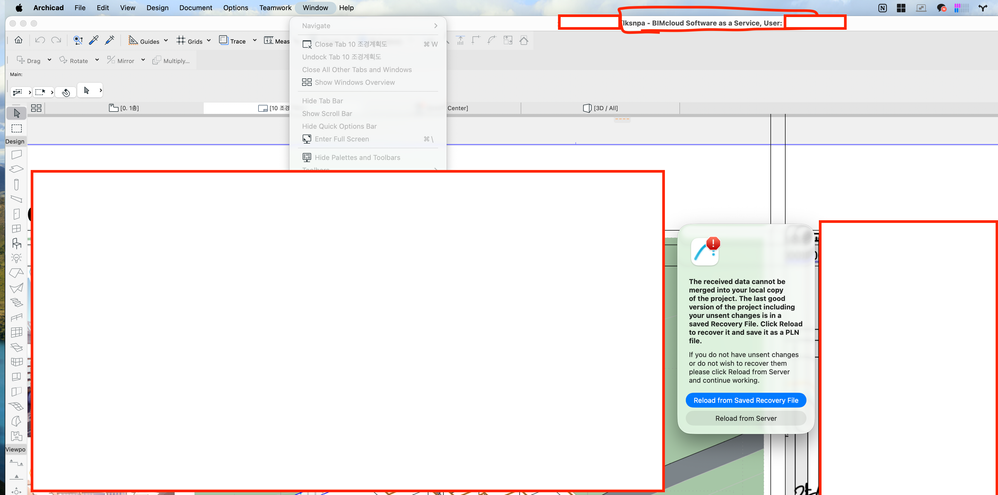

Archicad 29 is unusable due to Teamwork errors. Please review a measure to provide a partial refund
Archicad 29 is unusable due to Teamwork errors. Please review a measure to provide a partial refund of the Archicad 29 subscription fee.
Hello.
This is the first time in 14 years I have had such a terrible experience.
The client computers are Macs. The server is Windows 11.
The time servers are all identical, set to time.apple.com. (I even attempted to unify the time on the Windows server using the UTC method, but it was of no use.)
The error shown in the image below appears 3 to 4 times a day, causing about 30 minutes to an hour of work to vanish each time. I am suffering significant financial loss.
I converted from a perpetual license to a subscription and prepaid for 3 years.
The exact same issue occurs in SaaS as well. Only in version 29!
Graphisoft has completely failed with version 29.
What is even more despairing is that I have seen many reports of similar issues to mine in the community.
Yet, Graphisoft has absolutely no idea what the cause is.
I received a response telling me to clear the cache files and test again.
If the cache files are the problem, then why does version 28 work perfectly fine without issues?
Please take a look at what I have gone through over the past 2-3 days.

Lee KiSeong
Thank you Lee Hankins
I have tried re-sharing the save file in Teamwork and having members re-join the shared project multiple times, but the problem reoccurs within 2 to 3 hours.
2D work is at least quick to recover, as I can simply copy and paste.
However, if synchronization fails while working on 3D models, Layouts, or View Maps, it leads to massive financial loss. Every day!

Lee KiSeong
The problem reoccurs even when I follow the method you mentioned. I have likely tried every solution available on the forums. I wrote this post today after enduring this situation for over two months. I experienced this issue two months ago during the early launch of version 29, and I assumed it would have been fixed after two updates, but the exact same problem persists. Graphisoft does not know the cause. I cannot even remember how many reports I have sent.

Lee KiSeong
This error occurs in SaaS as well.

Lee Hankins
It’s got to be something to do with your setup or the files themselves. Like I say, we have 12 users working on Teamwork BIMcloud SAAS and previously prior to December 2024 we were using on premises BIMcloud and very rarely saw this error. Maybe once in a 12 month period. Therefore it can’t be a fault with Archicad or BIMcloud. It likely something your side causing a network issue. How reliable is your internet connection? Do you have any anti-virus that could be interfering with the BIMcloud connection?
