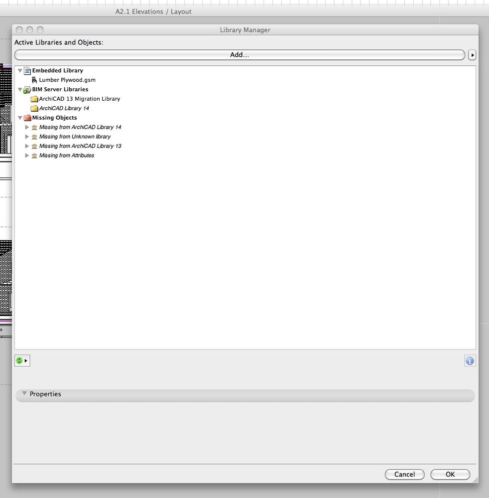

Ok, I created a teamwork file from an existing solo project. During the creation it asks if you want to bring in the libraries from the solo project, and I said yes, but when I create the teamwork file and go into it, all the libraries are missing (see attached screenshots). It says I have Library 14 loaded, but "ArchiCAD Library 14" is in italics, does this mean something?
Also, when I load the libraries onto my BIM server, do I want to load the whole AC 14 Library folder or just the .lcf?
I'm just trying to determine the correct way to go about creating the teamwork project so I don't have this constant issue of not having any libraries...

Nevermind - I did the bug fix and it worked. I didn't think we were using Bonjour but I guess we are...
I am having issues too! What bug fix are you referring to? Are you talking about build 3269?
